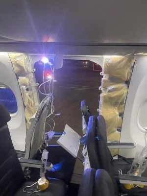

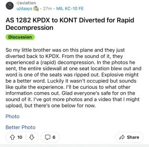

I’m looking to verify this post. Alaska 1282 #AS1282 did indeed divert almost immediately back to PDX tonight. Operated by a brand new #737MAX-9.
If this checks out, a hell of a lot more than just the window was lost. Possible an entire plugged exit door departed the aircraft?!

Har en sånn plugget dør falt ut før? Det er vel i praksis samme som de vel bruker på -900ER?
Re: Alaska Air AS1282 mistet tettet nødtutgangdør Boeing 737-MAX-9
Artikkel fra Reuters, som har en del info om flygningen, og uttalelser fra Boeing m.fl. https://www.reuters.com/business/ae...oeing-737-max-9-emergency-landing-2024-01-06/ Interessant quote under.
The MAX 9 features a rear cabin door behind the wings of the aircraft that can be "activated" in dense seating configurations to meet evacuation requirements, Flightradar24 said. However, they are permanently "plugged," or deactivated, on Alaska Airlines jets.

Alaska 737 Max 9 that lost deactivated exit had recent pressurization issues
Preliminary information about the accident remains scarce, though two people familiar with the aircraft tell The Air Current that the aircraft in question, N704AL, had presented spurious indications of pressurization issues during two instances on January 4. The first intermittent warning light appeared during taxi-in following a previous flight, which prompted the airline to remove the aircraft from extended range operations (ETOPS) per maintenance rules. The light appeared again later the same day in flight, the people said.
https://theaircurrent.com/feed/dispatches/alaska-737-max-9-that-lost-deactivated-exit-had-recent-pressurization-issues/

Hvordan kan man sjekke dette, fra innsiden må man fjerne paneler, fra utsiden må det en platform til.
En slik tettet nødutgang bør ha samme struktur som resten av flykroppen og tåle de samme belastningene.
De samme tettede nødutgangene finnes også på -900ER
