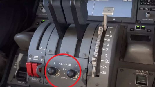

For consideration, here is a possible scenario that hasn’t been mentioned yet and encompasses the frailty of human performance. The report mentions that the flight crew on the immediately prior flight had written up a "STAB POS XDCR" status message, and that troubleshooting was carried out. I wonder if the scenario could be that the accident crew received a Stabiliser EICAS message on or around take-off and the Capt (who was PM) decided to action the first checklist item immediately from memory, by intending to move the Stab switches to Cutoff but moving the fuel switches instead. As in all modern Boeings, the Stabiliser Cutoff switches are immediately next to the Fuel Cutoff switches and operate in the same sense (i.e. down for Cutoff). They are guarded and never normally moved but, with an intent to move the stab switches, “muscle memory” (cerebellum activation if you prefer) may have taken the Captain’s hand to the Fuel switches, which are operated on every flight. The FO (who is PF) is manually flying at this stage sees and queries it. The Capt denies it, as he doesn’t realise what he has done (confirmation bias perhaps). After a few seconds, the terrible mistake is realised, and the fuel switches are moved back to run, but sadly too late and the Capt makes a Mayday call.

Av ren nysgjerrighet, er det god motstand i disse omtalte cutoff-bryterne når man skal dra dem ut av sin posisjon? Vil det være som en litt trang sigarett-tenner i en bil f.eks, eller kanskje mer som en løs USB-kabel.
Har alltid lurt på hvordan disse bryterne i fly føles. Jeg vil tro de føles mekaniske og solide.
De må som regel løftes opp før de kan bli flyttet.

«Fuel switches are operated on every flight». Ja og nei, selvsagt må de på, men det skjer kun en gang på bakken, og ikke av kaptein. Ingen muscle memory her. Og ingen med 15k timer vil tukle med noe rett etter rotation. Fly flyet er alltid nummer en, og det eneste som er viktig rett etter rotation.
En kaptein trener vel i simulator også på start og stopp av motorene som inkluderer å flytte på disse bryterne?
Hvis teorien over her stemmer, er det helt utenkelig at i en stresset situasjon under takeoff, hvor de får feilmelding «Stabiliser EICAS message», at muscle memory fikk kapteinen til å ta disse bryterne i stedet for ‘Stabiliser Cutoff’ bryterne som er plassert like ved siden, litt lenger ned?

Engine master switch henger absolutt ikke i taket. Engine master switch på en airbus er bak throttle quadrant, likt fuel cutoff på Boeing. Må løftes før de flyttes. Du tenker på Fire switch, som er stor og rød og er i taket.

Det er her filosofien bak designet skiller merkene veldig fra hverandre. Boeing har en haug med brytere i cockpit som hvis brukt feil kan føre til en alvorlig hendelse og i verste fall død. Og Boeing legger all makt i pilotenes hender så om de gjør dumme ting, vel, da skjer det alvorlige ting. Airbus derimot har en "hand of god" over pilotene som filtrerer bort dumme ting. Spesielt i forhold til flight envelope for å unngå stall, men også andre ting som at man ikke har en bryter lett tilgjengelig i midtkonsollen som kun brukes en gang på bakken før og etter hver flight. Faktisk har ikke Airbus noen fuel cutoff switch i det hele tatt. Det tar en datamaskin seg av og henger sammen med ekvivalenten i Airbus: Engine Master Switch. Den er i takkonsollen og beskyttet av et rødt deksel. Det er ikke noe man tilfeldigvis fikler med i lufta.
Interessant teori, men jeg kjøper den ikke. Stab trim er under røde deksler som vippes ned og så kan bryteren dyttes ned til cutout. Fuel bryterne er beskyttet med to stålvinkler på høyre og venstre side, og knappene må dras litt ut og dyttes ned, forbi en tydelig kant. Det er såpass forskjellige virkemåter på disse at jeg tviler på at noen ville forvekslet dem. I tillegg er ikke fuel cutoff en memory item og røres ikke i lufta med mindre ting er fullstendig krise ombord så.. Neppe.
