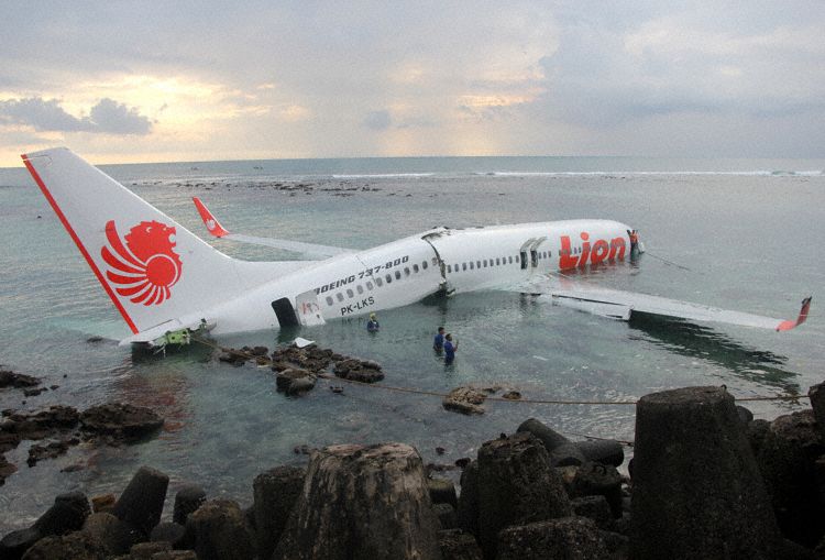

Accident: Lionar B738 at Denpasar on Apr 13th 2013, came to stop in seaA Lionair Boeing 737-800, registration PK-LKS performing flight JT-904 from Bandung to Denpasar (Indonesia) with 101 passengers and 7 crew, was on approach to Denpasar's runway 09 at about 15:10L (07:10Z), but came to a stop in the sea short of the runway, the aircraft broke up in two parts. All occupants were evacuated from the aircraft and have been taken to hospitals with minor injuries (scratches).
The airline confirmed flight JT-904 went into the sea while landing at Denpasar Airport. The aircraft PK-LKS originated in Banjarmasin and was scheduled to fly to Bandung (JT-945), Denpasar (JT-904) and back to Bandung (JT-905). The aircraft carried 101 passengers and 7 crew.
Radar data confirm the aircraft was approaching runway 09 and suggest the aircraft was about 100 feet below a 3 degrees glidepath descending at 700 feet per minute at a speed between 126 and 135 knots over ground, descending through 200 feet MSL about 1nm short of the touch down zone and 0.6nm short of the sea wall.
