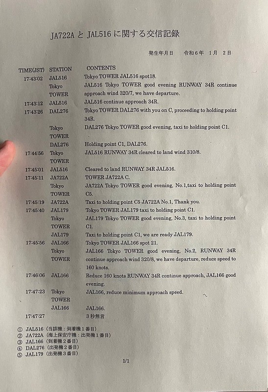

Fant denne postet på Fb, mulig oversettelsen ikke er korrekt.

Er dette fraseologien de bruker i Japan?
Re: Japan Airlines A350 krasjet med Japanske Kystvakten ved landing på HND 02JAN24
Det tror jeg ikke. Frigitt av Japan’s Ministry of Transport:

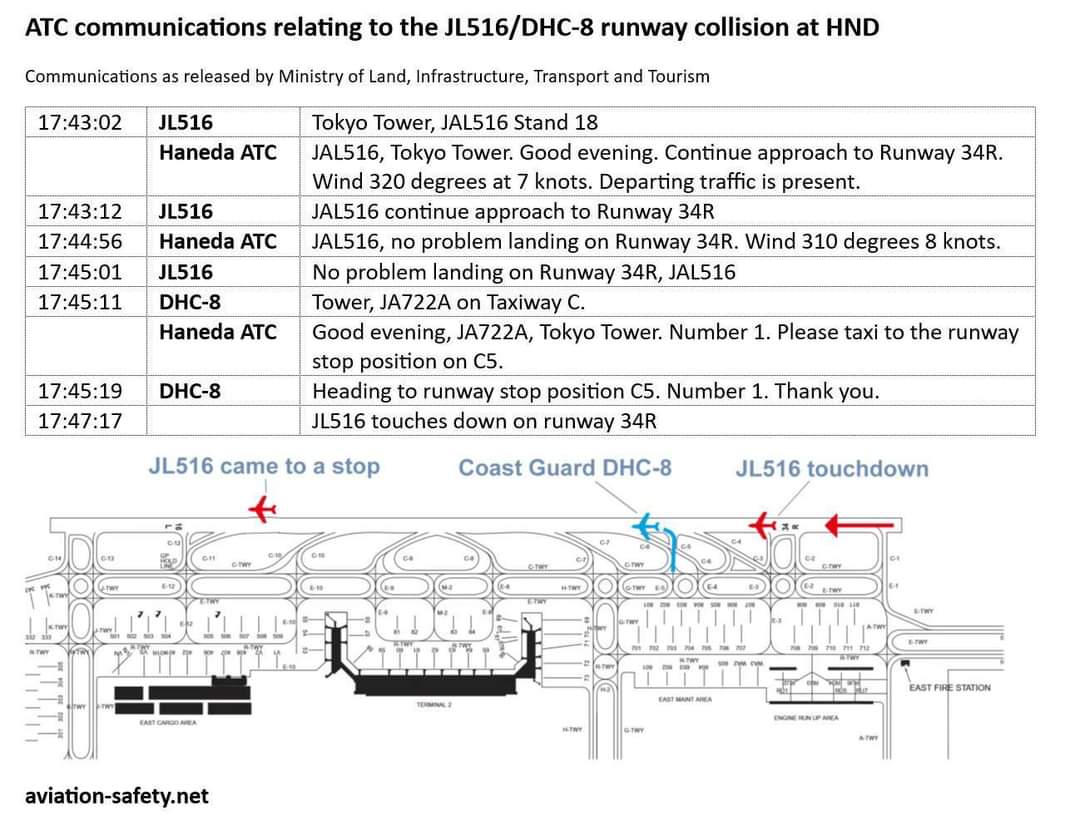

Oppdateringer;
(...) There were three pilots in the cockpit, none of them was able to see the DH8C, therefore a go around was never considered. After the aircraft came to a stop the cockpit crew was not aware of any fire, however, flight attendants reported fire from the aircraft. The purser went to the cockpit and reported the fire and received instruction to evacuate. Evacuation thus began with the two front exits (left and right) closest to the cockpit. Of the other 6 emergency exits 5 were already in fire, only the left aft exit was still usable. The Intercom malfunctioned, communication from the aft aircraft with the cockpit was thus impossible. As result the aft flight attendants gave up receiving instructions from the cockpit and opened the emergency exit on their own initiative.
On Jan 4th 2024 Japan's Ministry of Transport stated that it appears the tower controller was not aware of the Coast Guard DH8C on the runway. The pilots of the A359 did not see the DH8C and are currently being interviewed by the JTSB.
On Jan 4th 2024 Tokyo's Metropolitan Police reported in an interview with them the captain of the DH8C stated that suddenly a fire started in the back of or behind the aircraft. The Police is investigating whether the captain was aware there had been a collision with the passenger aircraft.
https://www.avherald.com/h?article=5132b9fe&opt=0

Hver bane har sin egen flygeleder og sin egen frekvens. Det er helt tydelig at Dash8 skulle krysse 34R for å ta av fra en annen bane og derfor var på en annen frekvens enn A350. Det må derfor være en god kommunikasjon mellom de som jobber i flytårnet.
Det stemmer ikke. Begge fly var på samme frekvens og det var meningen at Dashen skulle ta av på 34R.34R kan ikke krysses da den ligger helt ved vannet. To sentrale spørsmål blir hvorfor Dashen liner opp uten klarering, og hvorfor flyet kunne stå på banen i 45 sekunder uten at noen la merke til det.
Ostehullsmodell det her. Stop bars var vel u/s. I tillegg har coast guard forventing om å snike i køen fra intersection og er sikkert veldig innstilt på å være raske. Kommer ikke frem om det er avgang rett før det her siden 516 også får departure ahead, continue. Eller om flygeleder ikke har bestemt seg enda hvor avgangen blir siden neste også får departure ahead. Er noen minutter som blir interessante å finne ut av her. Minner om den i LA på 90 tallet. Fly linet opp i mørke som blir avglemt av flygeleder. Fly får landingsklareing. Lysene til Metroliner på rullebanen går i ett med banelys. Konklusjonen til ntsb var vel å ikke bruke rullebanene til mixed operations.
