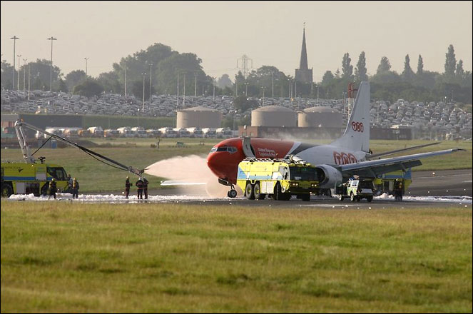

Birmingham stengt - understell kollapset på TNT 733
A freight plane has made an emergency crash landing at Birmingham International Airport after developing problems with its undercarriage.
The Boeing 737-300 landed on the main runway and collapsed on to its side. The two crew members were unhurt.
Mer fra BBC her: http://news.bbc.co.uk/2/hi/uk_news/england/west_midlands/5082200.stm
Replying to Topic 'Birmingham stengt - understell kollapset på TNT 733'
Og her hva det for øyeblikket står på førstesiden til BHX
Incident at Birmingham International Airport
We can confirm that an incident has occurred involving a TNT aircraft. The Boeing 737-300 aircraft, originally on route from Liege to Stansted Airport, was initially diverted to Nottingham East Midlands Airport due to problems with visibility at Stansted.
The pilot subsequently became aware of problems with the Aircraft undercarriage. This resulted in the Aircraft diverting to Birmingham and the Pilot declaring an emergency.
At 06:06, the aircraft landed. In line with operational procedures foam was used as a precautionary measure – no fire occurred.
There were two crew members on board and no passengers. No-one was injured.
As the aircraft is currently positioned on the runway, only a very limited operation can take place. The Air Accident Investigation Board is on site.
A shorter length of runway is available, which means that the airport can provide a limited service to airlines that use smaller aircraft. Other airlines will be making alternative arrangements for passengers.
Passengers should check-in as usual for departing flights. Some aircraft have been diverted to other UK airports, and airlines will be making alternative arrangements for passengers.
No further information is available at the moment.

Forøvrig kan den opplyses at flyet landet uten at høyre understell ikke kom ut i det hele tatt

Så en liten oppdatering vedrørende denne 733Fen.
Den skulle opprinnelig landet på Stansted, men siktforholdene der var dårlige, så derfor fløy til alternativ flyplass som East Midlands (EMA). Under landingsforsøket på EMA mistet den/fikk slått av sitt høyre understell etter å satt ned på høyre side av rullebanen med det ene hjulparet på gresset. Dårlig sikt, mistanke til feil med ILS, lang tjenestetid for de to i den skarpe enden diskuteres nå på pprune.

Litt mer info fra EMA om understellet som ble revet av skrevet av en som landet etter TNTen:
We reported the undercarriage to EMA tower (wheel tyre and strut). They were quite surprised. The undercarriage was in the grass between the Alpha taxiway and the runway about 300m from TDZ - we were actually quite reluctant to tell ATC as we assumed that they knew already - but prudently we did.
Kilde: pprune

Og TNT-flyet bommet mer enn først rapporter på rullebane 27 på EMA. Det ser ut de for fått med seg riktig GP, men har de ikke fått med seg LLZen. Bildet (bare en link siden den er 1500 pixels bredd) under viser merker etter flere hjulsett en bare styrbord hoved mellom rullebanen og taxiway Alpha og omtrent midt mellom Alpha 1 Hold og Whisky 1 Hold. Retningen ser ut til å bære i retning ytre deler av Central Apron og hvis en hadde forsatt i bakkenivå hadde den krysset Mike og endt opp inn på vedlikeholdsområdet.
http://mysite.orange.co.uk/il2skins/737_EGNX_copy.jpg
