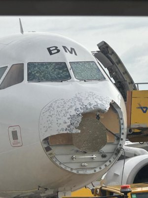

CFM
Da ser det ut til å være en 320 CEO mindre i drift en stund :(

Dårlig sikt...
https://x.com/aviationbrk/status/1799896040700575777

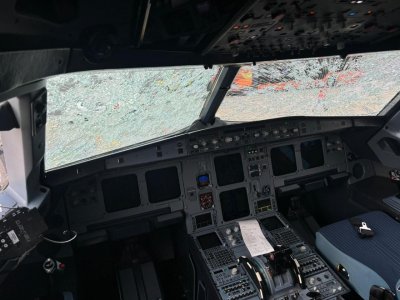

Skjønner godt at det snakkes pm luftens helter etter denne landingen.
Austrian OS434 truffet av kraftig hagl
Så denne just på twitter, virkelig godt jobbet av pilotene som lander med knuste vinduer
GPqG4_vXYAEH4eS
For mer, se her
https://abcnews.go.com/Internationa...e-cockpit-windows-austrian/story?id=110970221
Flight OS434 was flying from Palma de Mallorca, Spain, to Vienna, Austria, when it hit a "thunderstorm cell," Austrian Airlines said in a statement to ABC News. The hail caused damage to the cockpit windows, some coverings and the nose, which photos showed appeared to have broken off.
