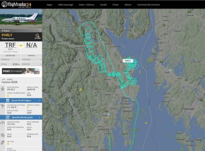

Et kamerahelikopter (AS350) og en Cessna 402 i 11000 fot ligger over det internasjonale sykkelrittet i Vestfold i dag. Noen som vet hvordan dette teknisk fungerer? Antar at det er video-feed, men...

https://www.flightradar24.com/blog/how-the-tour-de-france-goes-from-cycle-to-screen/
As the riders begin each stage, a fleet of motorbikes, helicopters, and fixed-wing aircraft spring into action. The motorbike-based cameras and the lower-level helicopters broadcast their camera signals to the relay aircraft circling above, which then send the signal to relay trucks in the area. Those signals are fed into a production truck where the director makes decisions about which camera to show. The production signals are then sent out via satellite and on to your screen. All of this happens in more-or-less real time.
Flightradar24 skrev litt om dette i forbindelse med Tour de France. :)
